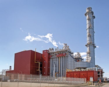

NYPA Astoria (Figure 1) is the latest addition to the fleet and the first large generating facility to have been built in the Big Apple in decades. The plant, while usually operating on natural gas, can run on kerosene (with a low, 0.04% sulfur content) for backup, but not for more than 30 days per year. The plant's main customers (about 10% of the total load) are government entities in New York City, including the school system, hospitals, and the Metropolitan Transit Authority's subways and commuter trains.
1. King of Queens. The 500-MW NYPA Astoria combined-cycle plant, adjacent to the Charles Poletti Power Plant in Astoria, Queens, entered commercial service on December 31, 2005. Courtesy: New York Power Authority
