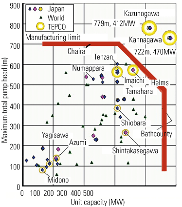

Historically, TEPCO's large pumped-storage plants have had extremely high effective-head requirements, and Kannagawa continued that tradition by pushing turbine manufacturing techniques to the limit. As Figure 3 shows, the utility's Kazunogawa Power Plant, whose first unit started up in 1999, set the bar high with a maximum effective head of 2,343 ft (1,015 psi) and a planned output of 1,600 MW. Just below it is Kannagawa, with a maximum effective head of 2,142 ft (938 psi) and a planned output of 2,820 MW. The units at both plants comprise vertical-shaft Francis turbines rated at 482 MW (max) and three-phase generator-motors rated at 525 MVA.
3. Bigger is better. Unit capacity and pumping head of pump turbines. Source: Tokyo Electric Power Company Inc.
