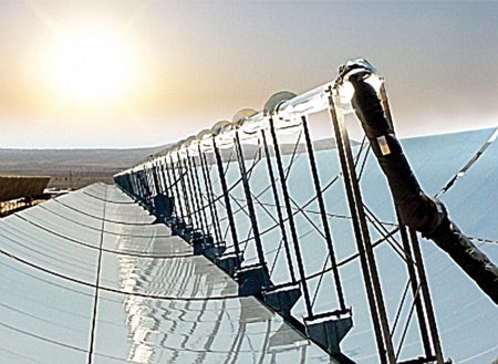

"Nevada Solar One" (Figure 7) covers 250 acres of the Nevada desert with arrays of solar parabolic concentrating troughs (Figure 7) that focus the heat energy of the sun on power-producing turbines. The plant's output will be sold to Nevada Power and Sierra Pacific Power under long-term power-purchase agreements.
7. Dishing up the sun. These parabolic concentrators in the Nevada desert have begun producing 64 MW of sun power for Sierra Pacific Resources' two Nevada utilities. They are similar to those used by earlier Luz solar thermal generation projects in California. Courtesy: Schott North America
Udo Ungeheuer, head of the solar power promoter Schott AG—a German glass maker that provided the concentrator technology—said at the end of June in Dusseldorf that the EU "should work towards establishing the necessary basic parameters so Europe can one day be supplied with power from solar thermal power plants based along the Mediterranean."
According to Ungeheuer, the parabolic trough technology "has already proven itself, and the costs of generating electricity will soon be competitive." Acciona Solar Power Inc., a subsidiary of Spain's Acciona group, built the plant and will operate it.
Similar to the Luz projects in California, the Nevada project has trough-shaped mirrors that concentrate sunlight onto absorber tubes along the focal length of the mirrors. The working fluid in the tubes is first heated to nearly 750F and then is pumped to a heat exchanger plant that transfers the energy to water used to make steam. The steam turns a steam turbine-generator. On cloudy days, a gas-fired generator is used to maintain the plant's output.
