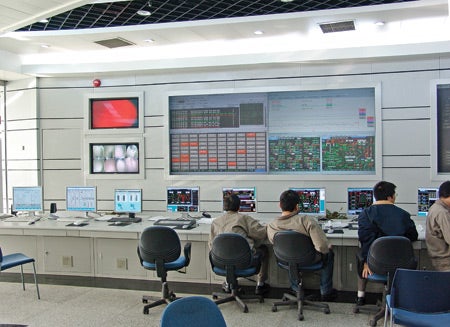

Ovation for huge new Chinese coal plant
The 1,000-MW Units 1 and 2 of the new, four-unit Huaneng Yuhan power plant in China have implemented expert control systems from Emerson Process Management (www.emersonprocess.com). Emerson, a major supplier of process controls to the electric power, water treatment, and wastewater industries, won the $7 million contract for the systems in April 2005.
The 4,000-MW plant, owned by Huaneng Power International, is the first to implement 1,000-MW ultrasupercritical technology in China. Emerson reports that Unit 1 completed its 168-hour performance test last November, and that Unit 2 was synchronized to the grid the following month. An Ovation expert system (Figure 9) monitors and controls the units' data acquisition system, modulating control system, sequence control system, furnace safeguard supervisory system, and major energy converters such as the boiler, turbine, and generator.
9. Megawatt maven. An Ovation expert system like this one is now controlling two of the four 1,000-MW units of a new, ultrasupercritical temperature and pressure coal-fired plant in Yuhan, China. Courtesy: Emerson Process Management
Emerson says its Ovation control system was designed specifically for the power generation business and has been used in thousands of installations. According to the company, the Chinese ultrasupercritical units at Yuhan "are currently the cleanest, most efficient, and most advanced in the world." Their reported 45% thermal efficiency compares favorably with the 30% to 38% efficiency of plants operating at subcritical temperatures and pressures.
