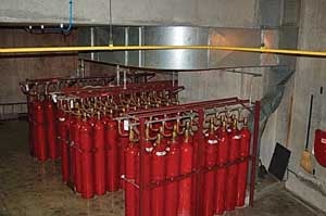

The traditionally used fire extinguishing agent at most hydroelectric facilities is carbon dioxide (CO2) because of its nonconductive properties and lack of residue. As a result of recent fatalities involving CO2 fire extinguishing systems (see "Review of the Use of Carbon Dioxide Total Flooding Fire Extinguishing Systems," Wickham Associates, August 8, 2003) and a general trend toward personnel safety awareness in the industry, CO2 is falling out of favor in some quarters. There are no regulatory mandates at this time that preclude the use of CO2 as a fire-extinguishing agent (Figure 2); however, there are some relatively new personnel safety requirements.
2. Got CO2? A bank of carbon dioxide cylinders stand ready to protect a hydroelectric generator. This arrangement includes an initial and extended discharge bank of cylinders plus a connected reserve bank of cylinders. Courtesy: PUD #1 of Douglas County, Wash.
CO2 is an excellent fire suppression agent, but it does have some significant shortcomings. Dangerous situations can occur if the proper safeguards described in NFPA 12, Carbon Dioxide Fire Extinguishing Systems, are not followed. The first drawback is that it displaces oxygen in a space and is thus lethal at concentrations necessary for flame extinguishment. In addition, the effectiveness of CO2 is highly dependent on the integrity of the protected enclosure, as leaks can dilute the concentration of CO2 to the point where it is no longer effective.

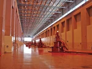

Generators. Hydroelectric generators have a rather unusual design, with relatively large open areas exposing miles of combustible winding insulation that can propagate a fire. There is an ample fire history involving these machines, especially generators with the older asphalt-based insulation materials. Current winding technology employs epoxy-fiberglass materials that have reduced the fire hazard (Figure 3).
3. Generator hall. A typical hydroelectric generator deck with 11 hydroelectric turbinegenerators rated at 1,300 MW total at the Rocky Reach Hydro Project on the Columbia River, owned and operated by PUD #1 of Chelan County, Wash. The first seven generators entered commercial service in 1961. Courtesy: Dominique Dieken
CO2 fire suppression systems are traditional for generator windings, although an acceptable alternative is deluge water spray. The application of water to a generator may appear counterintuitive at first glance, but there are no known cases where a properly designed water spray system has caused any significant damage to a generator. NFPA 851 recommends an interlock to ensure the water spray system trips the generator off-line before releasing water. A common method of protecting against inadvertent water spray discharge into the generator is to interlock the water spray system with both heat detection and a generator fault. NFPA 851 also recommends that the generator should be electrically isolated and run without excitation for at least 24 hours after a water spray discharge.
Unfortunately, guidance for when to provide a fixed fire suppression system for the generator is less clear-cut. NFPA 851 states: "[p]rotection of generator windings consisting of materials that will not self-extinguish when de-energized should be provided." NFPA 851 further explains that "[t]hermoset [insulation] does not require fire suppression systems."
One global insurer, FM Global (formerly Factory Mutual), takes a somewhat different approach. The current FM Global standard, Data Sheet 5-3/13-2, Hydroelectric Power Plants, requires fire protection systems for generators rated at 50 MVA and over, regardless of winding composition. The May 2008 update of the standard states that "FM Global has a report of a generator fire showing fault energies were sufficient to ignite and result in a self-propagating fire in thermoset insulation." FM Global made a recent proposal to change to NFPA 851 based on this event. The next edition of NFPA 851, in 2010, may include some changes based on recent outcomes.

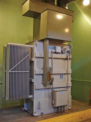

Transformers. The protection standards for outdoor oil-filled transformers holding more than 500 gallons are the same as those for conventional electric generating stations (Figure 4). In sum, all transformers must have secondary spill containment and either spatial separation distance between each other (25 feet up to 5,000 gallons and 50 feet for transformers with more than 5,000 gallons of oil) or firewalls.
4. Managing voltage. This indoor oilfilled transformer uses fire-resistive dielectric fluid and proper spill containment. Courtesy:Dominique Dieken

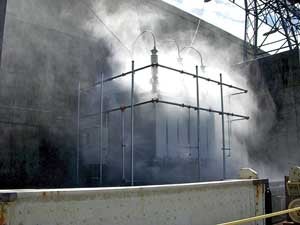

Although not explicitly stated in NFPA 851, using water spray systems is typically acceptable as an alternative if spatial separation distance or firewalls are impractical. Water spray systems, if provided, are typically for the protection of exposed transformers or structures, rather than for the protection of the transformer itself (Figure 5). We find that adding water spray systems solely for the benefit of the transformer itself is not cost-justified for transformers less than 300 MVA if adequate separation distance or properly designed firewalls are provided.
5. Ocean spray. The acceptance test of a new step-up transformer deluge water spray system
is under way. Note the firewalls on each side of transformer. Courtesy: PUD #1 of Chelan
County, Wash.
Oil-filled transformers located inside the powerhouse present a separate hazard, because a fire involving the dielectric fluid could severely expose the powerhouse and equipment to severe damage. Hazard mitigation includes replacing the mineral dielectric fluid with a listed/approved less-hazardous fluid, such as silicone or vegetable-based fluids. As an alternative, the transformer should be located in a fire-rated vault designed in accordance with the requirements of NFPA 70. Although this is not specifically required by the National Electric Code. the vault should be equipped with an automatic fire suppression system, such as CO2, water spray, or water mist.

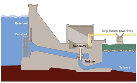

Fire Protection Water Supplies. Hydroelectric facilities have an advantage over their fossil fuel – fired cousins by virtue of having an unlimited supply of water for fire protection at their fingertips. Medium- and high-head hydroelectric facilities have an added advantage: The water is already under sufficient pressure for fire protection use.
As a general rule of thumb, an available supply pressure of 50 psi or more is adequate for most fixed water-based fire suppression systems. However, NFPA 14 requires that a Class I automatic wet standpipe have a minimum pressure of 100 psi, so one or more fire pumps may still be required. The maximum allowable pressure in a fire protection system is 175 psi.
When using a penstock as a water supply source, two separate auxiliary connections dedicated to fire protection water should be provided upstream of any other valves (Figure 6). In addition, an auxiliary water supply — such as a connection to a gravity tank, a pressure tank, a municipal water source, or a pumping system taking suction from the tailrace — can also be a fire water source when the penstock is dewatered.
6. Water works. Pressurized water from the penstock can be used for fire protection if the head pressure is sufficient. The tailrace (the channel that carries water away from the dam) can also serve as a water source when the penstock is drained for maintenance. Source: Tennessee Valley Authority

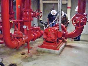

In the case of a low-head hydroelectric facility (such as run-of-the-river plants) the pressure must come from dedicated fire pumps. The pump suction source should be a dedicated and reliable one, such as independent connections to at least two scroll cases, although NFPA 851 does not provide specific guidance on this.
Size the water supply to meet the flow demand of the largest fixed fire protection system(s) plus a minimum hose stream demand of 500 gpm for a minimum duration of two hours. Be aware that the largest system demand might require multiple suppression systems to operate simultaneously. A typical fire pump rating is 1,500 gpm at 100 psi if deluge water spray systems are present. Note that with the proper suction conditions, a fire pump can operate anywhere on its operating curve, up to 150% of its rated capacity; however, in accordance with good fire protection engineering practice, the maximum anticipated flow should lie between 90% and 120% of the rated capacity. New fire pumps are required to be located in a separate two-hour fire-rated room.
Neither NFPA 851, other NFPA standards, nor model fire codes require a redundant fire pump; rather, the design is driven by the desired system reliability. Normally, prudent fire protection design, not to mention most insurance companies, require a redundant fire pump. The common design practice is to provide two electric-driven pumps with redundant power supplies. Connecting each pump to a separate transformer via a separate breaker or to a single power supply with an emergency power source via a dedicated transfer switch meets this requirement (Figure 7).
7. Double your flow. A typical fire pump system consists of redundant pumps located on a lower level of a powerhouse with completely separate power sources. Courtesy: PUD #1 of Chelan County, Wash.
