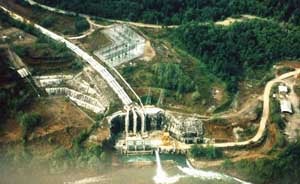

The generation system at the PT Inco smelter originally consisted of the Larona Power Station, commissioned in 1978 (Figure 1). The station was equipped with three Sulzer Francis turbines coupled to 65-MVA Hitachi generators. Due to the lay of the land, there is a 7-kilometer-long (4.2-mile-long) intake canal equipped with two radial intake control gates. The head pond at the end of the canal feeds three 1.3-km-long penstocks, which are large pipes that connect the head pond to the generators. The Larona units are equipped with bypass valves to protect the penstocks during load rejections.
1. Larona Unit 1's open bypass valve. As shown, the generator bypass valve will open to relieve pressure surges in the penstock in the event of a large loss of load. Courtesy: PT International Nickel Indonesia

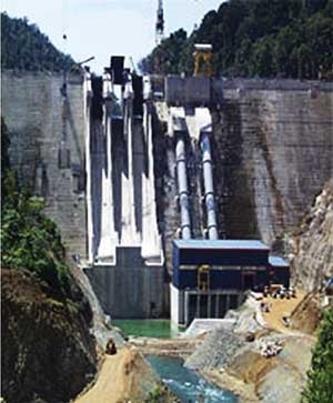

In 1999, the Balambano Power Station was commissioned (Figure 2). It was equipped with two GE Francis turbines coupled to 80.6-MVA GE generators. In 2002, Larona Unit 3 was upgraded with a 68-MVA GE generator. The new unit has significantly higher inertia than the original unit.
2. Balambano Power Station. The power house where the two generators are located is shown in the lower right. The two 90-m (295-ft) penstocks can be seen in the middle right portion of theimage. The three spillways in the middle left are used to allow water to bypass the generators during times of high rainfall or maintenance. Courtesy: PT International Nickel Indonesia
