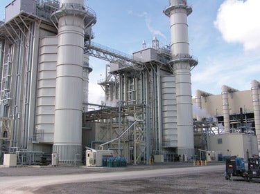

At first glance, Currant Creek is similar to many 2 x 1 combined-cycle plants based on the ubiquitous General Electric 7FA gas turbine (see the profiles of PSEG Power's Linden Generating Plant and Bethlehem Energy Center). It has a nominal generating capacity of 145 MW at its elevation of 5,051 feet. The two triple-pressure, horizontal gas-flow heat-recovery steam generators (HRSGs)—manufactured by Louisville-based Vogt Power International Inc., a subsidiary of Babcock Power Inc. (Danvers, Mass.)—generate low-pressure (LP) steam at 78 psig and 565F, intermediate-pressure (IP) steam at 462 psig and 1,048F, and high-pressure (HP) steam at 1,950 psig and 1,050F from turbine exhaust gas at 1,125F (Figure 4). Currant Creek is supplied by a 1,075-psig dedicated pipeline that brings gas to the plant from a trunk line 13 miles away.
4. Triple play. Vogt Power International supplied the two triple-pressure heat-recovery steam generators. Courtesy: PacifiCorp

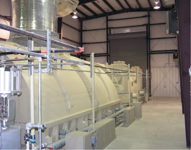

5. Made in Japan. Toshiba supplied the single 250-MW steam turbine. Courtesy: PacifiCorp
