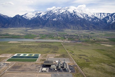

When Des Moines–based Mid-American completed the purchase of PacifiCorp from ScottishPower in late March of this year, one of its prizes was the new, natural gas–fired 525-MW Currant Creek Power Plant outside of Mona, Utah (Figure 1). Baton Rouge–based The Shaw Group Inc. (www.shawgrp.com), through its subsidiary Shaw Stone & Webster, provided all of the engineering, some of the procurement (PacifiCorp purchased the combustion turbines, the heat-recovery steam generators, the main transformer, and the switchyard components), and all of the construction services for the combined-cycle project—which is notable for having "gone commercial" twice, as we'll explain later.
 1. Flying high. PacifiCorp's new 525-MW Currant Creek Power Plant is 80 miles south of Salt Lake City, at an elevation of more than 5,000 feet. Courtesy: PacifiCorp

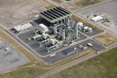

That the final bill for the project came in under $350 million (about $660/kW) shows that Shaw and PacificCorp know a thing or two about squeezing a plant construction dollar. For comparison's sake, a very similar, utility-built 2 x 1 plant equipped with the same gas turbines (but with a less-costly wet cooling system) that recently went into service in California cost over $410 million to build. Western ratepayers got a real bargain with Currant Creek (Figure 2).
2. Bargain building. Currant Creek is an outdoor plant that uses a huge air-cooled condenser to recover turbine exhaust steam. The entire plant cost just $350 million to build. Courtesy: PacifiCorp
