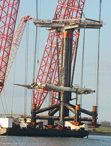

7. First commercial-scale tidal energy turbine. SeaGen’s 52-foot-diameter twin rotors will operate for up to 18 to 20 hours per day off the coast of Northern Ireland, producing up to 1.2 MW. Courtesy: Marine Current Turbines Ltd.
In April 2008 the first commercial-scale tidal turbine from Bristol-based company Marine Current Turbines, a 122-foot long inverted windmill dubbed the SeaGen, was installed in Strangford Laugh, a shallow inlet in Northern Ireland where tides gush in at speeds of up to 9 mph (Figure 7). Energy produced by the 1.2-MW device will be purchased by ESB Independent Energy, a retail subsidiary of Ireland’s national electricity company—and one of the first utilities to provide tidal energy to its customers.

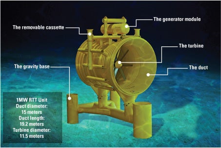

Deep-sea tidal farms. British tidal company Lunar Energy plans to construct two deep-sea tidal farms. One would consist of eight underwater turbines on the sea bottom in Pembrokeshire, South Wales; the other would be a colossal 300-turbine field in the Wando Hoenggan Water Way off the South Korean coast. The latter project, a collaboration with Korean Midland Power Co., is a $1 billion scheme that extracts power from fast-moving deep-sea tidal streams. Lunar Energy will utilize 60-foot-tall Rotech Tidal Turbines, each with a 2,500-ton frame containing a pump, generator, motor, and electronics (Figure 8). The project entails a full resource research and feasibility study, and if successful, it will be operational by 2015.
8. Harnessing tidal power. Each 60-foot tall Rotech Tidal Turbine consists of a 2,500-ton frame containing a pump, generator, motor, and electronics. Courtesy: Lunar Energy
