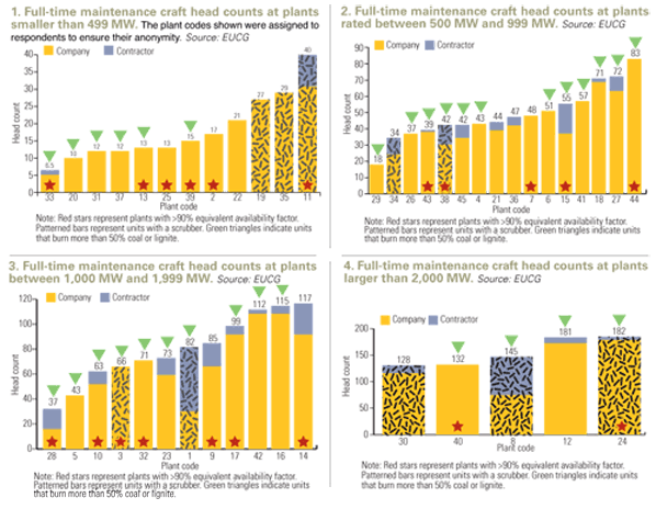

Figure 1 illustrates the full-time craft maintenance head count at small plants (<499 MW) in the reporting sample, identified by company and contractor. To enable comparisons on an apples-to-apples basis, head counts include I&C and full-time contractors but exclude supervisors, planners/schedulers, regional maintenance workers, plant cleaners, occasional contractors, and non-craft maintenance personnel. Figure 2 shows the maintenance craft head counts at plants rated between 500 MW and 999 MW, Figure 3 shows the counts for plants between 1,000 MW and 1,999 MW, and Figure 4 reflects plants larger than 2,000 MW. The plant codes shown below the bars were assigned to respondents to ensure their anonymity.

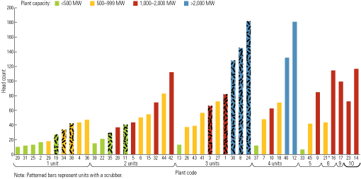

Maintenance craft head count appears to be a function of the number of units in a plant, but only up to a point. For example, Figure 5 shows that head count varies widely, but—not unexpectedly—increases sharply when a plant has larger units. Higher head counts also seem to be the case for plants configured with FGD systems.
5. Full-time maintenance craft head count by number of units per plant. Source: EUCG

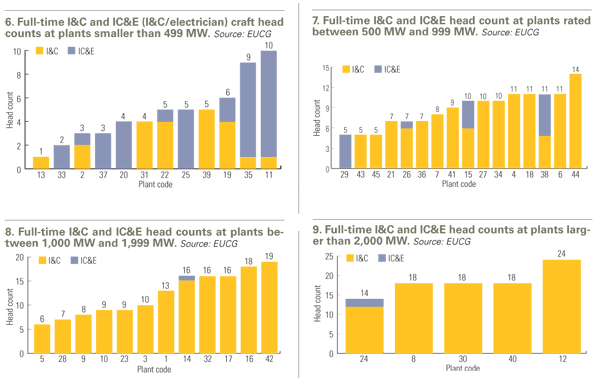

The study results also indicate that some plants cross-train their I&C technicians to make them combination I&C techs/electricians, or IC&Es. Figures 6 through 9 show the head counts for this craft category in the same four plant size categories as Figures 1 through 4 for full-time maintenance craft personnel. The next layer of survey detail, available only to survey participants, correlates I&C head count with the presence of a DCS and an FGD system. The IC&E staffing strategy was found to be more prevalent in smaller plants than in larger plants.
