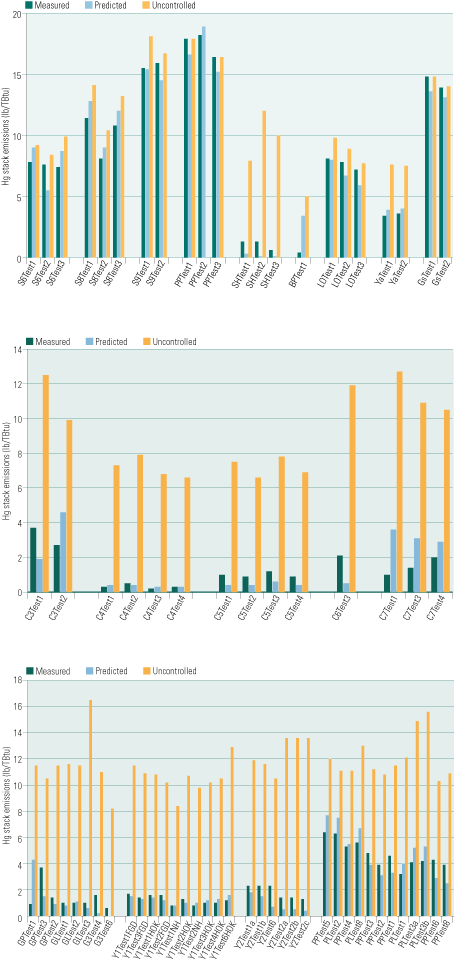

Test data from more than 50 full-scale gas cleaning systems have already been interpreted by MercuRator. Each individual test was simulated independently with readily available test-specific coal properties and gas cleaning conditions. The predicted Hg emissions rates are directly compared with test data (Figure 5) for systems with PCDs alone and SCR/PCD/scrubber combinations, and for systems that use sorbent injection for Hg control. The measurement uncertainties usually fall within 10% to 15% of the total Hg inventory. The standard deviation (SD) of the predictions (Table 2) are well within this tolerance for SCR/PCD and SCR/PCD/scrubber combinations, very close to it for sorbent injection applications and systems with PCDs only, and somewhat greater for PCD/scrubber combinations.
5. Educated guesses. A comparison of measured (green bars) vs. predicted (blue bars) Hg emission rates for flue gas cleaning systems with particulate control devices only (top), SCR/ESP/scrubber combinations (middle), and activated carbon injection (bottom). Uncontrolled emission rates also are shown, as orange bars. The rates were predicted for individual tests to make test-to-test variations apparent. Source: Niksa Energy Associates LLC
