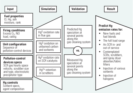

The modeling tools developed by Niksa Energy Associates solve that problem. Because they are based on dynamic reaction analysis (DRA), their equations account for the rates of all chemical reactions in a gas cleaning system that affect Hg emissions (Figure 2). As the flue gas cools along a gas cleaning system, the reaction rates in a DRA-based model automatically slow down at different rates, and high-temperature bottlenecks give way to new bottlenecks at cooler temperatures. Different fuel qualities and cleaning conditions also affect these rates, as does the injection of chlorine or other halogens and sorbents into the flue gas stream. The rates used for catalytic Hg oxidation along SCR systems are faster than the rates for the in-flight Hg chemistry.
2. Predicting Hg levels. Users enter fuel properties and gas cleaning conditions into simulations, based on dynamic reaction analysis, of Hg speciation along the flue gas cleaning system. Once the predictions have been validated with baseline Hg test data, the simulations can predict how emissions will vary as fuels, cleaning conditions, and the configuration of pollution control systems change. Source: Niksa Energy Associates LLC
