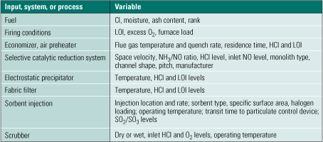

Compounding the problems caused by variability in coal properties, the conditions of flue gas cleanup also directly affect the underlying Hg chemistry and therefore directly determine Hg emissions rates (Table 1). As examples, different flue gas quench rates imposed by different designs of economizers and air preheaters can affect Hg reaction rates. Longer ductwork sustains more chemistry than shorter connections. Utility SCR systems are operated at space velocities from 1,700 to 5,000 hr-1, which changes the residence time available for catalytic Hg oxidation by almost a factor of three. In addition, different SCR units use different flow passages and active ingredients that also affect Hg oxidation rates.
Table 1. Flue gas cleaning conditions that affect Hg chemistry. Source: Niksa Energy Associates LLC
