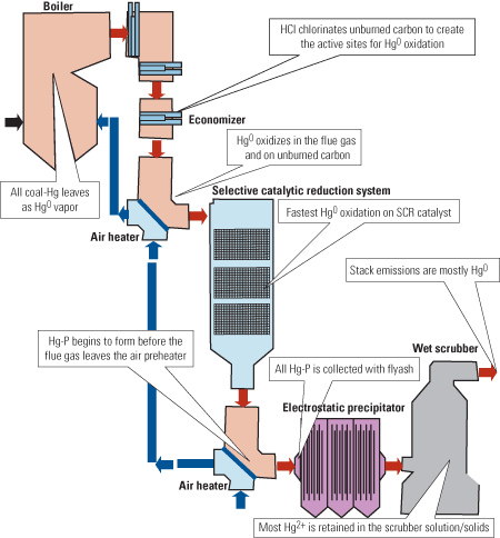

The clearest perspective on Hg removal comes from recognizing Hg speciation as a marker for the various chemical reactions that transform mercury as it passes through a gas cleaning system (Figure 1). The starting point for this chemistry is very well defined because all the Hg fed into the furnace with the fuel will be present as Hg0 at the furnace exit. But after the flue gas is cooled by an economizer, the Hg0 starts to oxidize into Hg2+ via reactions in the flue gas, and does so at an even faster rate via reactions on suspended particles of UBC.
1. Mercury lifecycle. Hg speciation changes from pure Hg0 vapor at the furnace exit to changing mixtures of Hg0, Hg2+, and Hg-P, depending on the levels of Cl and unburned carbon, whether an SCR system is present, and many other cleaning conditions. Source: Niksa Energy Associates LLC
Hg0 oxidizes even faster along the catalyst in a selective catalytic reduction (SCR) system. By the time the flue gas leaves the air preheater, it is cool enough for Hg0 and Hg2+ to bind to UBC or to any sorbents injected to recover it as Hg-P in a downstream PCD. The mixture of Hg0 and Hg2+ leaving the PCD will be stripped of almost all its Hg2+ by a wet scrubber. Therefore, most of the Hg that exits the stack will be Hg0 vapor whenever a scrubber is present.
Hg chemistry is governed by changes in temperature through the cleaning system, the residence time of its various devices, and the concentrations of the participating species. But none of these parameters is the same for different gas cleaning systems, or even for the same system on different days. As a result, the otherwise confounding variations in Hg speciation measurements are due mostly to differences in the Hg chemical environment that naturally arise among utility gas cleaning systems.
