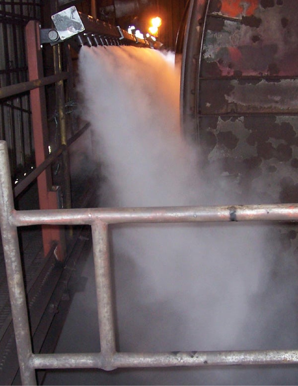

Like any technology, fog systems must be properly applied to achieve the desired results. With fog systems, a fuel-handling transfer point is a “scrubbing chamber.” Gilroy says that each chamber must be designed so that airflow is properly managed, such as by having adequately sized conveyor skirt covers at the conveyor load point. This is an important consideration for foggers because air movement must be slow so that the fog droplets injected into the transfer point will have sufficient retention time to attach to the airborne dust particles and settle them out on the belt. The design must have enough cover height for the air to expand and enough length for agglomeration to occur (Figures 1–4).
1. Gravity works. The Dust Solutions Inc. (DSI) dry fogging system agglomerates the airborne dust particles to micron-sized water droplets so that when the particles become heavy enough, they are returned to the product stream by the force of gravity. With conveyor transfer points, there must be sufficient room for the fog to fully develop, particularly in the receiving belt area. In addition, the conveyor skirt boards must be tight, and the inspection and conveyor covers must be in place so air leakage does not affect the efficiency of the system. Courtesy: Dust Solutions Inc.

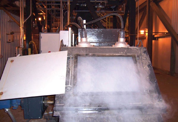

2. Blanket of fog. The system design is based on a unique nozzle design that can produce a very dense fog of 1- to10-micron-size water droplets that literally blanket the dust source and keep the dust particles from becoming airborne in this rail car unloading system. The DSI nozzle requires a maximum of 15 psi water pressure. Courtesy: Dust Solutions Inc.

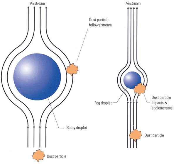

3. Droplet size matters. For agglomeration of the dust particles to occur at the dust source point, two conditions must occur: Enough water droplets of the same size as the dust particles must be present, and both dust and water droplets must be constrained to the same volume so that agglomeration can occur. If the water droplet’s size is too large, the dust particle will follow the air streamline and miss the water droplet. Source: Dust Solutions Inc.

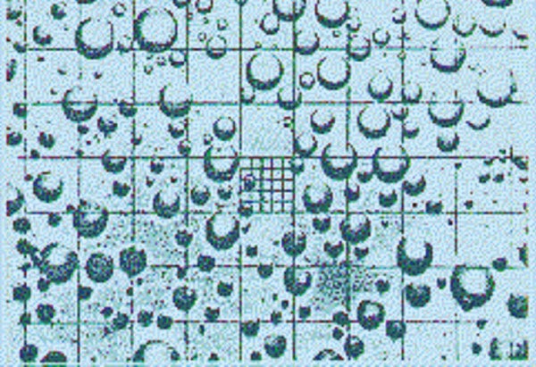

4. Micron-scale water particles. An actual high-speed photograph of droplets generated by a DSI fogger designed to produce water droplets less than 10 microns in diameter. The droplets were captured on a greased microscope slide in a chamber that was at 100% relative humidity to eliminate evaporation of the droplets. The small squares are 2 microns across. Any fugitive dust particles encapsulated by such densely packed fog droplets have little or no chance of escaping. Courtesy: Dust Solutions Inc.
