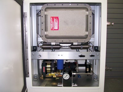

A contaminant measurement and monitoring technology must be used that can detect and measure aerosols as well as solid particles, if they are present. The technology must also handle contaminant coating and perform its analysis at pipeline pressure and temperature. As particle size measurement was determined to be the most important parameter to monitor, laser-produced light-scattering technology was selected for the application. Laser particle counters have gained wide acceptance as clean room dust and aerosol monitors (Figure 2).
2. Tracking down contaminants. The PlantGard high-pressure gas pipeline contaminant monitor can detect and measure aerosols and solid particles. Data from the monitoring system are normally communicated by serial or analog cable to plant digital control systems. Source: PECOFacet/Scientific Process Solutions Inc.
The system developed includes a sampling probe that is inserted about one-third of the way past the pipeline wall. The sampling probe will flow a continuous sample of gas up through a sampling line that feeds the laser particle-counting flow cell. After passing through the flow cell, the discharge gas is pumped back into the pipeline with a pneumatic-driven compressor that is an integrated part of the monitoring system.

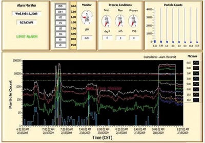

3. On the alert. The PlantGard web dashboard is shown recording changes in the natural gas’s cleanliness. Source: PECOFacet/Scientific Process Solutions Inc.
Data from the monitoring system are normally communicated to the plant digital control system (Figure 3). A real-time data stream is also web-based for secure viewing from any Internet connection. Particle count trend lines are monitored for each particle size channel or registry. Alarm level thresholds are set for critical registries. Increasing levels of contaminant will always increase the particle count. Experience has proven that film flow will produce a proportionally increasing aerosol content as the film content increases. The particle count data are used to measure the relative amount of contaminant flowing in the line (Figures 4 and 5).

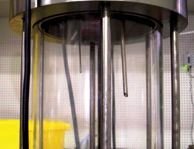

4.    Clean bill of health. The clean gas flow in the pipeline illustrates normal clean gas fuel conditions. Source: PECOFacet/Scientific Process Solutions Inc.

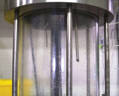

5.    Caught in the act. The wet gas flow in the pipeline illustrates a liquid contaminant upset. Source: PECOFacet/Scientific Process Solutions Inc.
Particle size distribution data help indicate what’s happening in a pipeline. For example, a coalescer element seal failure will continuously produce particles in the 1- through 8-micron range, whereas a properly working filter coalescer will have an effluent stream containing only low levels of particles less than 1 micron. A coalescer element starting to lose its removal efficiency due to solids loading will produce a gradual increase over time of all particle sizes. Liquid slugs from the upstream pipeline result in an immediate jump in particle counts. Cataloging contaminant events to their resulting particle size distributions has proven to be a powerful diagnostic tool.
