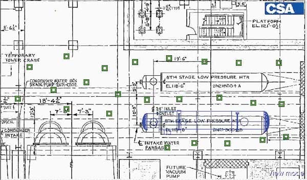

Laser scan the expected removal path. Laser scanning is planned according to potential rigging path areas. It is important to cover areas affected both by equipment movement and by temporary rigging structures. A plan view of an equipment floor shows the scanner locations for the heater removal site as green boxes (Figure 2).
2.    Location planning. The location plan of an equipment removal area with scanner locations shown as green squares. Source: CSA Inc.
High-resolution, 360-degree laser scanners are then used to collect the digital plant data. These scanners provide a very good dimensional representation as well as a very good visual representation of the area. The scans are typically made during a planned outage if the area is not accessible during normal plant operation.

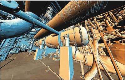

Create the laser scan 3-D database. The laser scans are first registered to the plant coordinate system. The registration also synchronizes the 3-D representation to any 3-D models created to support this application. The scan database is available in a visual 3-D format to allow the user to measure any locations or distances within the scanned space. The scanned database is also available in 3-D CAD (surface model) format representing scanned surfaces. This format can be transferred to any CAD system as a background for design and is also used for interference checking (Figure 3).
3.    Paint your surface. An example of a surface CAD format generated from a series of laser scans. Source: CSA Inc.

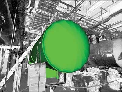

Model in 3-D the equipment to be removed. A 3-D model of the equipment to be removed is prepared from the vendor drawings. The disadvantage is that the equipment to be removed may have extended parts, which may not be obvious from the installed configuration. The equipment 3-D model can have tolerances added to verify possible "close call" interferences. The equipment to be removed is then verified against the scans and any necessary corrections and adjustments are made. If the new equipment is different from that being replaced, a 3-D model of the new equipment is made for the equipment replacement simulation. A tolerance can also be added to the new equipment model.

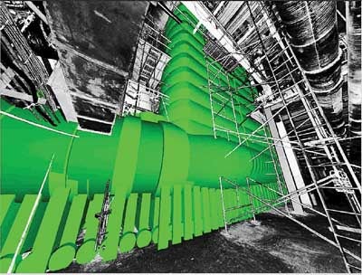

Model in 3-D the rigging equipment and supporting structures. A 3-D model of the rigging equipment and supporting structures is prepared and added to the overall database. This 3-D model can be merged within the scans and verified for the intended use. (Figure 1 also shows a good example of how a rigging plan can be added to a equipment drawing.)
Create the removal path and simulation sequence. Determine the removal path for equipment removal and replacement. Several alternative paths can be identified to verify possible removal options. The equipment can be rotated and lifted as necessary over the removal path (Figure 4).
4.    Moving day. A CAD model of the equipment to be moved can be superimposed on a laser scan 3-D model showing the removal path. Source: CSA Inc.
Documentation of the equipment translation/rotation sequence is stored in a special motion-simulation file. This file is used to move the equipment through this path. The result is a 3-D version of the equipment translation/rotation through the plant. The simulation may also include moving of the rigging equipment as necessary.

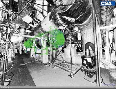

Remove the old equipment from the scan database. Equipment to be removed can be eliminated from the 3-D model, and then applicable scans are reprocessed. Figure 5 provides an example of where a vessel was eliminated from the 3-D scan model of the original plant equipment.
5.    Delete from memory. Equipment originally included in the 3-D scans (top) can be electronically “erased” from the CAD file (bottom). Source: CSA Inc.

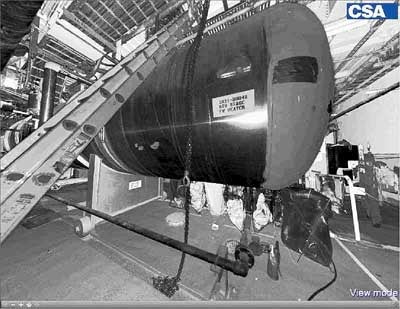

Merge the equipment removal sequence within the scans. The equipment to be removed is replaced within scans by the 3-D version of the equipment (Figure 6).
6.    Add from CAD. The model of the moved equipment is merged with multiple scans within the plant along the removal route. Source: CSA Inc.

Using PanoMap, the user can review the equipment’s movement process through all the scans. Notes, labels, and instructions also can be placed in individual scan views. Additionally, any electronic drawings, procedures, photographs, or documents can be hyperlinked to the scans (Figure 7).
7.    Model movement. When the moved equipment models are merged, a complete view of the path can be displayed. Source: CSA Inc.

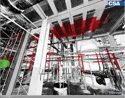

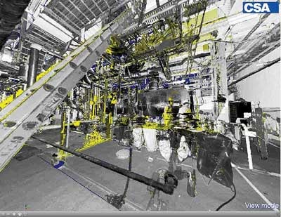

Check for interference. The laser scans within the removal sequence are reprocessed to show interferences between the moved equipment and the plant background. Interferences are shown in red within the scans. The user can review these scans and adjust the removal sequence or plan for the removal of interfering components. Scans with marked interferences can be reviewed with the 3-D solid representation of the equipment throughout its trajectory or path (Figure 8).
8.    Get out of my way. Interferences checks are also automatically performed as part of an integrated removal sequence. Areas shown in red are interferences. Source: CSA Inc.
