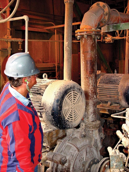

Flyash causes wear and corrosion in piping
Unit 2 began to have problems with abrasion in the pipes when transporting flyash to the plant’s scrubber (Figure 5). “We have a very abrasive situation,” said Dennis Ziniel, mechanical maintenance supervisor for Minnkota Power. “The flyash is very abrasive and very corrosive.”
5. Flyash problems. Minnkota Power Cooperative’s 455-MW Young Station Unit 2 experienced excessive pipe abrasion and corrosion caused by transporting flyash to the plant’s scrubber. Courtesy: Abresist Corp.
The flyash is a product of burning the lignite coal. Lignite coal produces two types of ash--bottom ash and flyash--when it is burned. Bottom ash is a heavy ash that is removed as a molten slag that flows out the bottom of the boiler. Flyash goes through the boiler and is sent to the scrubber to help scrub sulfur dioxide from boiler exhaust gases.
The Young Station has two scrubber towers that are about 40 feet in diameter and 160 feet tall. Inside the towers are nozzle heads that spray the flue gas as it passes through with a liquid mixture that contains a combination of limestone and flyash. The spray scrubs the sulfur dioxide out of the gas by combining it with the calcium in the limestone and flyash. This slurry is then pumped to settling ponds. The water is drawn off the top of the settling pond and recirculated and reused in the scrubber system.
Young’s staff tried fiberglass and stainless steel pipes to reduce the wear from the flyash, but other problems soon arose with those pipes. “Lined fiberglass stands up fairly well for a limited time in some applications,” Ziniel explained. “We’ve got some fiberglass here that’s been in service about 10 years, but we’re starting to see some real issues with it.”
“We also have other applications where we’ve gone with grade 316 stainless steel because it is so abrasive and so corrosive,” Ziniel continued. “But stainless steel is very, very expensive.”

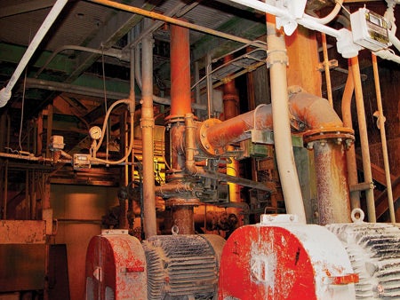

Young Unit 2 needed a solution to the pipes’ wear problems, so Minnkota Power took a look at Abresist Corp.’s cost-efficient lined piped solution. In 1988, Young Station purchased approximately 400 feet of 2-, 3- and 4-inch Abresist lined piping at half the cost of stainless steel piping priced at $200 to $300 per foot, including about 35 elbows and tees, for transporting the flyash to its scrubber. Abresist lined pipe consists of flanged steel shells lined with thick cylinders of cast basalt, an extremely hard volcanic rock that is very good at resisting sliding abrasion. Since installing the Abresist lined pipes, the pipes have not needed to be repaired or relined (Figure 6).
6. Almost legal. Abresist piping was installed at Young Station Unit 2 on the flyash transport piping 20 years ago, after plant managers rejected fiberglass and stainless steel pipe alternatives. The pipes have not required any repairs or relining since installation. Courtesy: Abresist Corp.
Lined pipes vs. fiberglass and stainless steel
“As a maintenance supervisor, I have a lot of problem areas I have to worry about,” Ziniel said. “But one of the areas I don’t have to worry about is the Abresist lined pipe, because I know it’s there and it’s working and I know I’m not going to have an issue with it.”
Though fiberglass pipes are less expensive than Abresist basalt-lined pipes, fiberglass pipes require more maintenance and repair. If the joints on fiberglass pipes are not lined up perfectly, turbulence is created and the fiberglass pipe begins to erode more quickly. “We have several spots like that where we are continually repairing it because they were not perfectly matched up when they were put together,” Ziniel noted.
Stainless steel may hold up against the flyash, but it presents other problems for the plant in addition to its higher cost. Young Station sometimes has build-up in its stainless steel pipes. When the temperature outside drops, a chemical reaction with the slurry occurs, and the slurry adheres to the inside of the pipe. A cleaning contractor then must use high-pressure washers to get rid of the build-up. “That is a very lengthy process. And very costly, too,” Ziniel admitted. “How badly the pipes are built up determines how long the contractors are here. We’ve had cleaning contractors out here for up to two weeks at $600 an hour. But, with the Abresist basalt-lined pipes we haven’t had any build-up, so Abresist lined pipes kind of give you the best of both worlds.” And since build-up is no longer a problem, the plant can save thousands of dollars that were previously spent on cleaning contractors.
