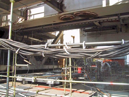

During power plant overhauls, those myriad "temporary" cables and hoses snaking everywhere don't just make it harder to complete the project on time and under budget. They also represent a potential hazard to personnel and sensitive equipment like workstations. A Dutch firm, Westmark BV (www.cablesafe.com), has developed an inexpensive hook (Figure 6) that gets cables and hoses off the ground, eliminating them as possible causes of damage to gear or injuries to workers.
6. Mine or yours? To make it clear which contractors own which Cablesafe hooks, they can be ordered in different colors or even engraved with a name. Courtesy: Westmark BV

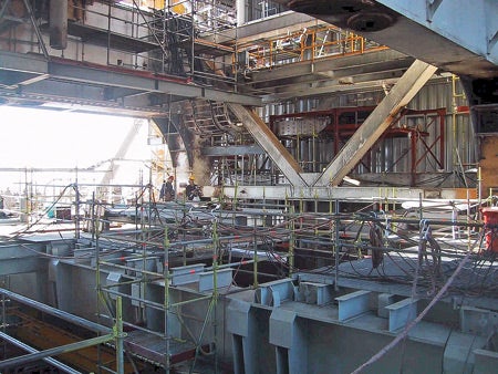

Cablesafe hooks earned their stripes at Dutch offshore oil and gas rigs and petrochemical plants by improving safety on decks, stairs, and scaffolding. Now, during a "turnaround" or shutdown of most plants owned by giants in both industries, contractors must use the hooks to suspend all their utility cables. Studies indicate that more than 20% of the accidents on overhaul projects are falls by workers who tripped on an electrical or welding cable or a fire or air hose.
These simple, S-shaped hooks are made of very strong, nonconductive, and inflammable reinforced polyester. They can be used again and again. During emergency situations, Cablesafe hooks help keep escape routes free of obstacles that can endanger the lives of plant personnel and firefighters.
Because the hooks are nonconductive, they eliminate the risk of inadvertently "frying" equipment or electrocuting workers. Based on experience, their use also reduces the number of temporary cables and hoses needed on a project and increases the longevity of those used by minimizing damage to them by sharp edges (Figure 7).
7. Safety first. Cablesafe hooks come in three sizes, and each clearly states its maximum load. At each end of the hook, there's a hole large enough to accommodate a cable tie-wrap. Courtesy: Westmark BV
