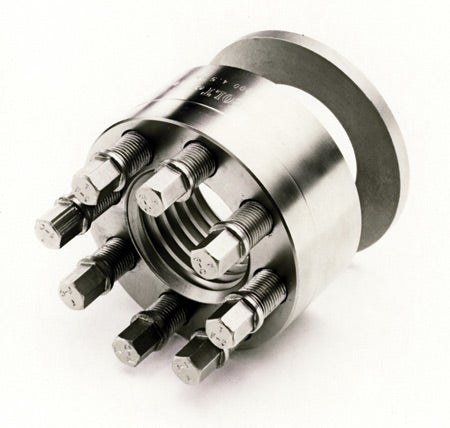

To address these problems, about four years ago Halas switched from standard nuts to multijackbolt tensioners (MJTs). An MJT (Figure 10), which can be used to retrofit existing nuts or bolts, is installed hand-tight against a hardened washer. Instead of turning the entire nut, though, an MJT uses a series of jackbolts threaded through the body of the tensioner. The jackbolts can be tightened by a garden-variety handheld torque wrench or air gun. For this particular job, Halas ordered the type of jackbolts with lock-wire holes in them (called Superbolts) as an extra precaution against loosening.
10. Tight fit. A nut-style multijackbolt tensioner can be tightened by a handheld torque wrench. Courtesy: Superbolt Inc.
"Our mechanics really enjoyed installing the Superbolts since it takes just one person with a small ratchet wrench," said Halas. "They're very easy to install, very easy to disassemble and—because they use pure tension—there's no chance of damaging the bolt threads."
