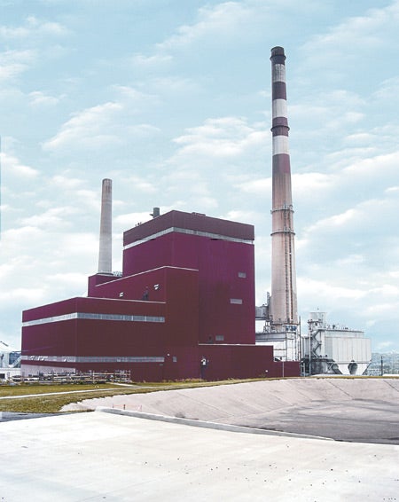

The E.W. Brown Generating Station of Kentucky Utilities (KU) is located in the town of Burgin, about 30 miles southwest of Lexington. The plant's three generating units burn an average of 1.5 million tons of coal annually, delivering some 750 MW of power (Figure 1). By 2005, the control technology that had been installed 35 years prior was beginning to show its age and replacement parts were becoming harder to find. KU's management concluded that the long-term benefits of replacing E.W. Brown's aging control systems warranted the investment. The goal became keeping the cost as low as possible.
1. Time for a change. All three units of Kentucky Utilities' E.W. Brown Generating Station need to have their controls systems upgraded. Some systems are three decades old, and replacement parts have become scarce. Shown is Unit 7. Courtesy: Invensys Process Systems

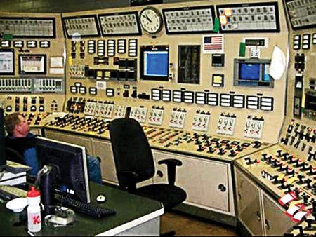

Most of the controls were so old that they required total replacement, from field device wiring and terminations through the controls. However, the field wiring, terminations, and cabinets of the data acquisition controls serving one of the Brown plant's three units—Unit 7—were still intact (Figure 2).
2. Feeling its age. After 35 years of loyal service, the old control room was ready for a facelift. Courtesy: Invensys Process Systems

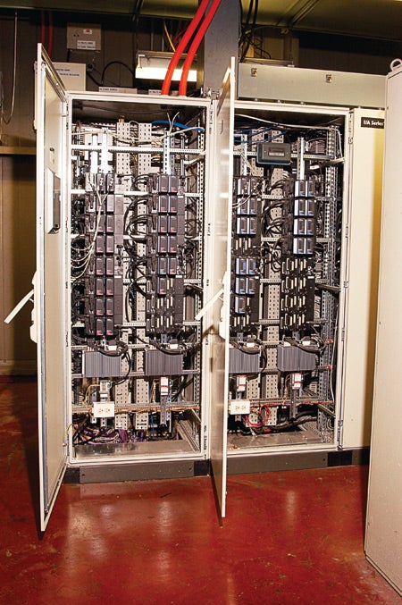

Because the I/A Series I/O modules plug easily into existing cabinets and racks, there was no need to move process wires or enlarge the system's footprint. All that had to be added at the Brown plant were controllers and workstations (Figure 3).
3. Fits like a glove. I/O module replacements fit into existing cabinets and racks, saving the existing wiring and installation time. Courtesy: Invensys Process Systems
