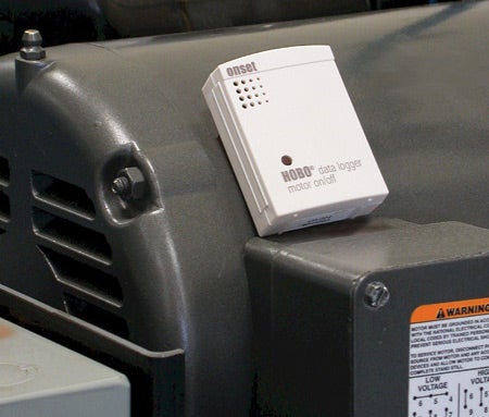

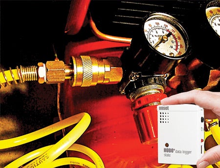

HOBO State loggers (Figure 6) are compact, battery-powered devices used to track changes in the operating status of a piece of equipment. In practice, a unit does just one job: recording every time that, say, a motor or compressor turns on or off, as well as the direction of the transition. For this customer, Jenkins’ team attached one HOBO to each of the factory’s three main compressors and then let it monitor changes in status over a two-week period (Figure 7).
6. On the job. A Hobo State unit monitoring transitions of an air-operated valve. Courtesy: Power Concepts LLC
7. Big iron, small plastic. Another kind of Hobo, riding the rails of a compressor motor. Courtesy: Power Concepts LLC
