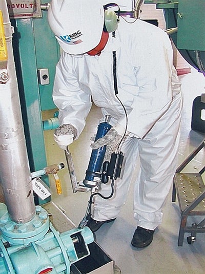

2. Improved lubrication processes. Proper lubrication practices can’t be taught in the classroom; they require that trainees reach out and touch the equipment. A good example is the “Grease Caddy” that senses high-frequency emissions produced by bearings and tells users when to lubricate, when not to lubricate, and when to stop lubricating to optimize bearing life. Courtesy: UE Systems Inc.
