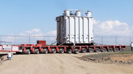

5.	Close quarters. Barnhart used a 14-line Goldhofer electronically steered trailer to maneuver a new transformer into place at this combined-cycle plant being built in Kansas. Courtesy: Barnhart Crane & Rigging
Last summer, Barnhart Crane & Rigging was hired to receive one generator and one turbine from a railroad, haul them more than 8 miles to a power plant rising near Emporia, Kansas (Figure 5), and then set them on their foundation. As part of the contract, the company also was supposed to install three transformers that it had hauled to the site earlier and had placed on stands and beams for temporary storage.

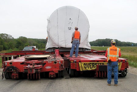

The major delivery challenge was a bridge crossing. Fearing a collapse, the bridge’s engineer would not allow the generator and turbine to cross on a single-wide Goldhofer. He insisted that Barnhart spread the load.
The solution was to begin the haul using a single-wide Goldhofer. Then, as the bridge was approached, another Goldhofer was brought alongside. The crew then slid the generator over to the middle of the now double-wide trailer (Figure 6). Once the bridge was crossed, the operation was reversed and the journey continued in a single-wide configuration.
6.	Double-wide load. Bridge load limits required Barnhart to double up single-wide trailers. Courtesy: Barnhart Crane & Rigging
