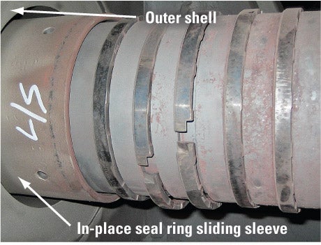

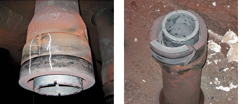

  • Replacing bell seals or piston seal rings that are cracked or broken (Figure 7) or have excessive clearance/taper or erosion. The inner cylinder nozzle chambers or inlet pipes may require refurbishment if they are eroded or worn. Any unused bell seal retainer nut lock screw holes should be welded up as they can be a source of main steam leakage. Some piston seal ring designs (Figure 8) can produce excessive leakage if installed improperly, upside-down (one side is flat, and the other has alternating high and low sides).
  • Checking inlet sleeves for cracks in the trepan radius using the turbine manufacturer's test method. In Westinghouse BB44s that are routinely found to have cracked bell seals, distorted inlet sleeves could be the problem (a consequence of age); the manufacturer offers a method for straightening the inlet sleeve that SCG has used successfully.

7. Yet another source. Cracked and broken main steam inlet bell seals on a Westinghouse BB44. Courtesy: Southern Company Generation
8. One-way street. The alternating (high- and low-side) piston seal rings of a 50-MW Westinghouse reheat turbine. Note that the rings are installed correctly, with the hi-lo side opposite the outer shell. Courtesy: Southern Company Generation

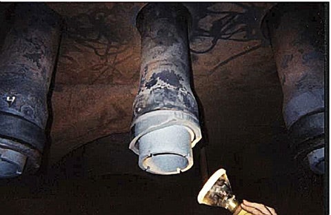

Since the No. 7 and 8 valves on this unit are upper inlet valves (narrowing the scope of the problem), the decision was made to remove the upper half of the outer cylinder. Doing so revealed a broken bell seal on the No. 8 governor valve inlet sleeve (Figure 10). Fortunately, the broken portion of the seal could be extracted from the inner shell, minimizing the duration of the outage.
10. Untrained seal. A broken bell seal on the sleeve of the No. 8 governor valve of a 500-MW Westinghouse BB44 steam turbine. Courtesy: Southern Company Generation
