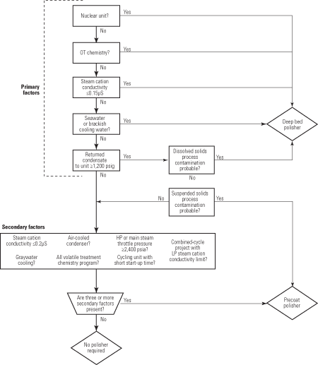

So far we have surveyed the technology and several technical factors that affect the decision to invest in a condensate polishing system. This discussion raises an interesting question: Is it possible to assess the need for a condensate polisher based simply on high-level plant design data?
We believe the answer is ”yes” and present a decision tree for selecting condensate polishing equipment that we find useful in our work. The decision tree uses a series of primary and secondary technical factors to arrive at a polisher solution (see sidebar). The decision tree is primarily a screening tool; final purchase decisions must be weighed against the specifics of a plant site, makeup water, and first-cost and life-cycle cost considerations.
Bechtel Power has been involved in many condensate polisher evaluations during the past few years. Below, we share five project case histories that illustrate how our condensate polisher selection guide (Figure 4, in sidebar) was used on particular projects. These case histories also illustrate how additional plant design criteria and owner preference will enter into the final selection decision.

None of the five primary factors in the selection guide applied to this unit, but secondary factors did: the throttle pressure, a steam cation conductivity limit of 0.2 µS/cm, and a condensate system designed to operate on AVT chemistry. Based on the selection guide, a precoat condensate polisher was selected for this project. The final design provided for 2 x 100% precoat polisher service vessels.

None of the selection guide’s primary selection factors came into play, and only two of the secondary factors were present, so no condensate polisher was required. However, based on the owner’s preference, a 1 x 100% precoat condenser polisher was included as part of the plant design. The precoat polisher was selected because of its ability to handle the high levels of iron transport associated with an ACC operating in cycling service. The potential for carbon dioxide in the condensate, due to air in-leakage in the ACC, was another key factor in its selection.
