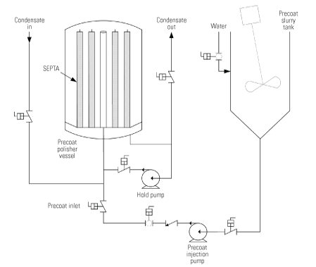

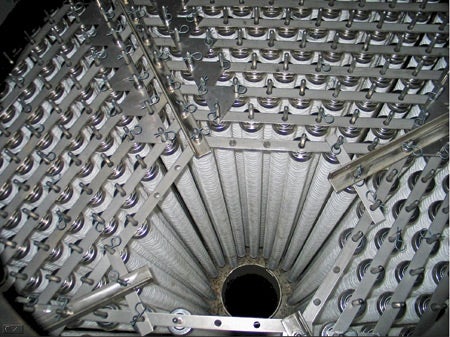

Precoat condensate polishers use a thin coat of powdered ion exchange resin applied to specially designed retaining elements called septa to treat the condensate stream. To create the powdered resin mixture, resin beads are ground to about 200 mesh and mixed with a fibrous fill media. The powdered resin mixture is blended with water to create slurry that is applied to the septa to form a ⅛- to ¼-inch precoat layer (Figure 2).
2. Coat of many layers. In this vessel with multiple internal filter elements, slurry of powdered ion exchange resin was applied to condensate polisher filter elements. Courtesy: Graver Water Systems
This thin coat of resin will remove some dissolved contaminants from the condensate, but its capacity is quite limited due to the small quantity of resin used. However, the elements do extremely well at filtering suspended particles from the condensate. Once the precoat condensate polisher is loaded with suspended solids or the ion exchange capacity is exhausted, the spent material is backwashed off the septa to waste and is replaced with a fresh layer. Figure 3 depicts a typical powdered resin application system design for precoat condensate polishers.
3. Slurry delivery system. A simplified flow diagram of a powdered resin mix and coating system. Source: Bechtel Power Corp.
