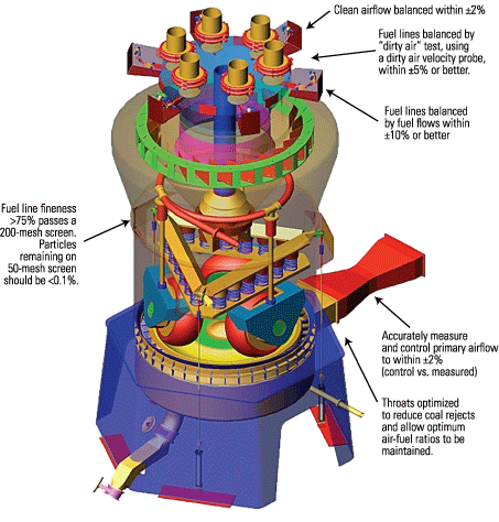

Comprehensive diagnostic testing is commonly used to supplement plant instrumentation monitoring because of the accuracy desired. For example, sampling representative ductwork cross-sectional areas is important to accurately measure combustion airflow, and fuel conduit traverses are needed to optimize pulverizer and burner performance. Fuel fineness also has a huge impact on the flow distribution across the fuel conduits, because there is a point where very fine fuel mixed with air behaves much like a homogenous gas (Figure 4).
4. The key is coal fineness. Poor coal fineness often yields poor distribution as large coal particles and air mix to form a two-phase mixture that will not homogenize (left). Good fineness creates a homogenous and balanced mixture that behaves more like a gas than a mixture of air and fuel. Source: Storm Technologies Inc.

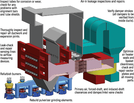

Finally, a system of semiannual combustion airflow device calibrations and periodic air heater performance tests were instituted to optimize the performance of the steam generator. Continuous attention to the daily details of inspecting and maintenance of key components is a must for Unit 2 to remain at peak performance (Figure 5). SEC has those tasks well in hand.
5. Stick with the system. Typical maintenance activities required during an outage related to fuel-flexible boiler operation. Source: Storm Technologies Inc.

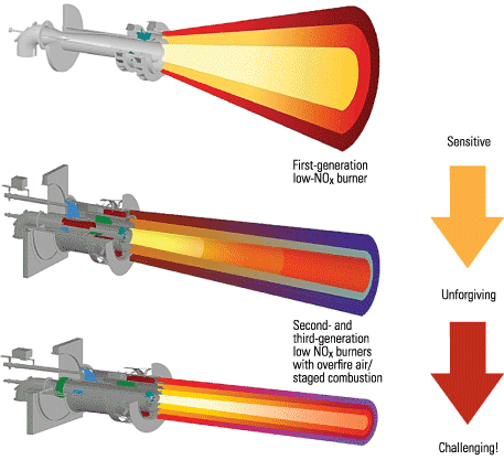

One of the most significant drawbacks of firing higher-sulfur coals containing high levels of iron is increased slagging, fouling, and fireside corrosion. The combination of staged combustion for low-NOx firing and operations with high-sulfur coals has long been a challenge for plant operators battling fireside corrosion and the thinning of boiler tubes (Figure 6).
6. Low-NOx burners have evolved. The complexity and difficulty of tuning low-NOx firing systems continues to increase. Source: Storm Technologies Inc.
