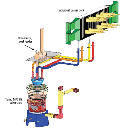

Just as important as maintaining the correct air-fuel ratio in the coal pipe from the mill to the burner is proper balancing of the air-fuel ratio between each mill and its burner. This is especially important because the path from each mill to the burners has a different pipe length and elevation to each of the five burner banks (Figure 3).
3. Injecting solid fuels. A properly tuned pulverizer; instrumentation to measure pulverizer throat velocity and venturi and orifices airflow; and a microprocessor-based gravimetric load cell coal feeder are required to balance the coal pipes from each mill to an individual burner and between the five mills. Fuel lines are also monitored for fuel fineness and distribution by periodic manual measurements. Source: Storm Technologies Inc.
Average boiler stoichiometry may not be a useful indicator for balancing mill performance, because the unit might be air rich on one side and fuel rich on the other. To obtain optimum performance in the furnace, air and fuel flows need to be balanced within acceptable tolerances. Our experience has shown that primary and secondary air flows should generally be balanced to within ±5% of the average, while fuel flow should be balanced to no more than ±10% of the average on a pipe-to-pipe basis. Keep in mind that 7% air imbalance and 14% fuel imbalance are conservative values for typical coal-fired plants. Not surprisingly, localized high-temperature zones and/or localized slagging issues are not uncommon under these conditions.
One of the first steps taken by the team was to balance the air-fuel lines within ±2% of airflow as part of a comprehensive fuel line–balancing process that accounted for:

Plant technicians also began conducting periodic (quarterly or semi-annually, based on fuel quality) mill performance tests to optimize coal fineness and air-fuel ratios to the burners; at the same time they inspect classifiers to confirm that they are set with optimum tolerances. The coal feeders were also calibrated or refurbished as needed, and each mill was renewed to factory specs.
