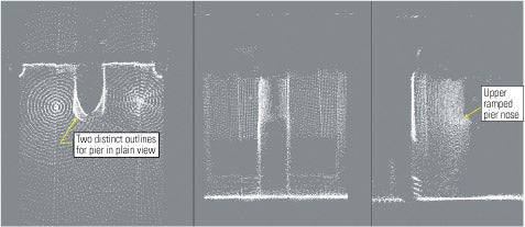

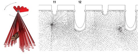

Because sonar scans made by the ASI system are made along two axes, more details of submerged components perpendicular to the structure also are recorded. That was not the case for the initial, profiling scan of an intake structure shown in Figure 2; because the lines never reached the pier noses, their details were not captured. In the subsequent dual-axis survey (Figure 3), the scans were not only perpendicular to the face of the intake, but they also were made at roughly 3-degree increments over 180 degrees to intersect the pier noses. Details of the stepped pier noses are clearly visible, confirming as-built information that was previously in dispute. Figure 4 is a side-by-side-side representation of the three-dimensional data produced by the ASI system.
3. Richer perspective. Here's the same survey area shown in Figure 2 as pictured (without the contour lines) by a scanning sonar operating in dual-axis mode. Only four system setups were needed to generate more than 15,000 data points, which reveal more detail of pier noses than conventional perpendicular scans. Source: ASI Group Ltd.
4. Deeper understanding.
A representation of the scanning sonar's 3-D data set showing intake openings and pier details. Source: ASI Group Ltd.

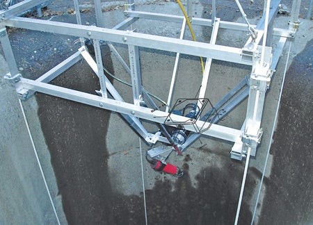

The initial plan was to perform several horizontal scans using a profiling sonar system, but the client was concerned that even with a vertical resolution of 1.5 ft, some details might be missed. Conducting another series of short vertical scans around the circumference may have been able to capture the missing details in the radial direction, but this would have been very time consuming. In the end, ASI proposed a more elegant way to scan in the vertical and radial directions at the same time: by mounting the system at a 45-degree angle, rather than horizontally (Figure 5). As a consequence, the shaft was surveyed in diagonal slices of elliptical shape.
5. Double duty. Here the scanning sonar head is mounted at a 45-degree angle on a secondary stepper motor. Courtesy: ASI Group Ltd.

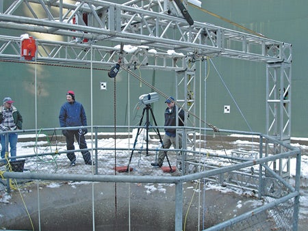

The shaft survey was completed in less than three days, well within the customer's maintenance outage window of 10 days. The upper portion of the shaft and the surrounding surge tank were scanned by a high-resolution, close-range laser unit (Figure 6). Data from the laser were processed and merged with the sonar data to create a comprehensive data set for the overall shaft. Four temporary benchmarks, set into the floor of the surge tank, were also surveyed and combined with the data set. They can subsequently be related to geodetic survey points at the client's convenience for integration with the known benchmarks.
6. Multimedia show. These are the laser scanner and targets used for the topside survey. The framework over the shaft was used to support the dual-axis sonar survey. Courtesy: ASI Group Ltd.

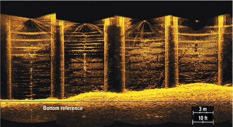

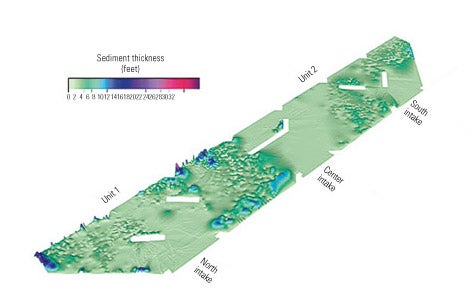

Forebay sediment monitoring. Intake structures are only the first link in a long and complex plant water-supply chain. It's also important to regularly inspect the other "out of sight, out of mind" assets in this system—headrace tunnels, intake channels, forebays, wet wells, discharge channels, tunnels, and pipelines. By monitoring the buildup of sediment in and on these structures at several points, a dual-axis scanning sonar system can optimize their cleaning and maintenance schedules (Figures 7 and 8).
7. Get the picture? In this representation from an imaging scanning sonar survey of a submerged intake structure, pier noses, trash racks, and debris accumulation can clearly be seen. Source: ASI Group Ltd.
8. Relief map. This isometric view of a sediment map was produced by a survey of a pump well forebay. Deflector walls and piers are outlined on the plot. Source: ASI Group Ltd.
