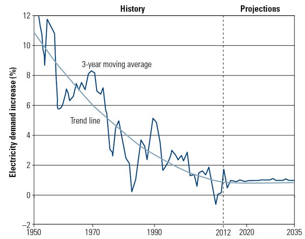

The notion of a lock-step relationship between economic growth and electric demand has skeptics. One is Jim Rogers, the long-time industry executive now in charge of North Carolina’s Duke Energy. Rogers told an industry conference recently that the past 50 years’ trend of economic growth driving electric sales growth is changing. Rogers said at the Edison Electric Institute’s financial conference in Orlando in November that structural changes in the U.S. economy are altering the relationship between the economy and electricity. “I do not see the manufacturing base coming back. Our economy is becoming less energy intensive, by 3% each year,” he said (Figure 1).

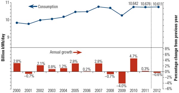

1. Electricity consumption is fairly flat. Total U.S. electricity consumption grew only 0.3% in 2011, and the EIA expects 2012 electricity consumption to decrease by 0.6% compared to 2011. Last year, the EIA predicted that electricity growth would be stagnant in 2011 and then resume long-term growth of about 1.5% per year. Historical data show that from 2000 to 2009, demand grew by 0.5% per year. Source: EIA, Short-Term Energy Outlook, November 2011

The EIA notes that summer 2011 was somewhat warmer than usual, with cooling degree-days through August about 2.8% higher than the same period in 2010. That put no real strain on the U.S. power system, except in Texas, whose grid is isolated from the rest of the country, where a prolonged heat wave and drought caused some outages and voltage reductions. For 2012, the EIA says it expects total consumption of electricity to shrink by 0.6%, compared to projected 0.3% growth for 2011 (Figure 2).
2. Future electricity growth is flat. The EIA predicts that electricity growth will be a negative 0.6% during 2012 but will recover and grow at 1% per year in following years. Source: EIA, Short-Term Energy Outlook, November 2011
