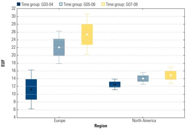

Changes in utilization patterns, in turn, have influenced reliability, efficiency, and cost. As shown in Figure 2, the unavailability of European coal plants as measured by equivalent unavailability factor (EUF) increased dramatically during the study period, compared to a modest increase among North American units. EUF is defined here as the fraction of maximum generation that could not be produced due to unit deratings and planned and unplanned outages. While planned outages increased slightly for both European and North American plants during the period, the increase in unavailability among European coal plants was driven by a doubling of unplanned outages.
2. Cycling plants increases outages. Equivalent unavailability factor (EUF) for coal plants in the EU has steadily risen since the EU ETS commenced operation in January 2005. At the same time, there was a modest increase in EUF in North America. This indicates that the increased cycling of EU coal plants has also increased the periods of time when the plants are out of service for repairs or are derated. Source: Solomon Associates
