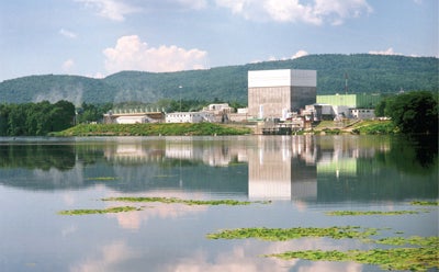

The latest problem has been at Entergy’s Vermont Yankee plant, a relic from the early 1970s (Figure 3). The 540-MW General Electric boiling water reactor (BWR), licensed to operate in 1972, has was leaking radioactive tritium offsite until repairs were made in late March (see sidebar).
3.    Tainted reputation. Vermont Yankee is battling Vermont residents for approval of a 20-year license extension. Leaking tritiated water from the plant has further alienated residents, even though there are no public health effects. Courtesy: NRC

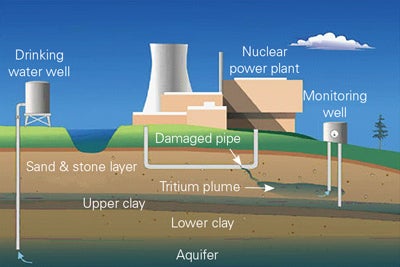

NRC Chairman Jaczko made note of the Vermont tritium issue in his remarks at the Platts conference. "The headlines have not been pretty," he said. "As a scientist, I know the relative risk of tritium. In the grand scheme of radiation, it is well down the scale, but in the area of public perception, it takes on greater significance."
Jaczko added that the Vermont Yankee problem echoed an earlier problem at the Oyster Creek plant in New Jersey, an iconic GE BWR that went into service in 1969 and the oldest reactor now in commercial service. Oyster Creek also had offsite tritium leaks. "That episode told us great deal about how buried pipe behaves over the years," he said, "and the importance of ensuring that the right piping is installed in the first place."
