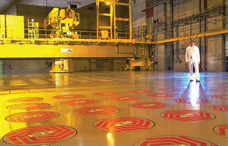

However, French nuclear law does not allow AREVA or any other entity to take waste and keep it in France. Although the recovered uranium and plutonium can be recycled for new fuel, the vitrified waste products are returned to the country of origin or another third party, as long as it is not in France. Therefore, Italy has to take back its vitrified waste products at some point in the future, but no later than 2025 (Figure 4). Other countries that ship their UNF to France for reprocessing must adhere to the same requirements.
4. Under foot. The vitrified waste is kept in storage cells located below the floor at the La Hague facility. Courtesy: AREVA
