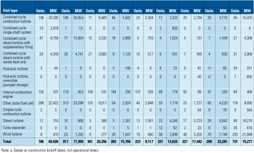

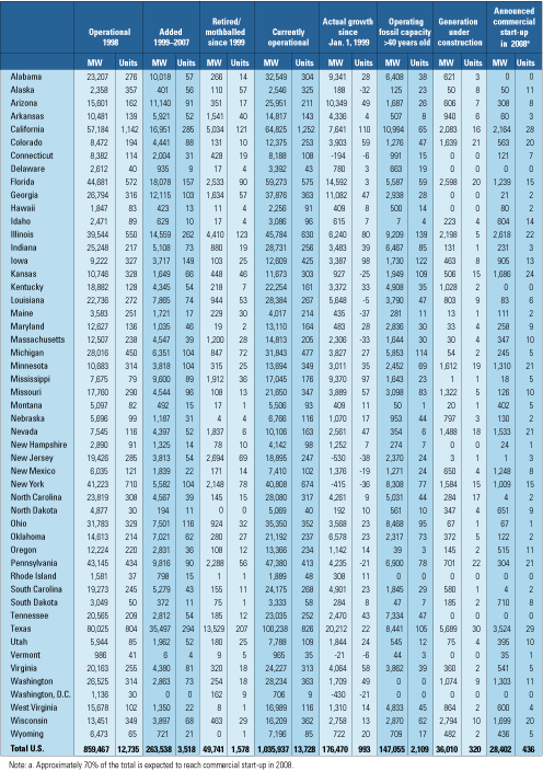

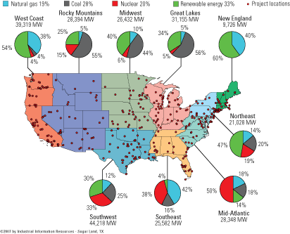

Continued economic growth in the U.S. over the next several years will inevitably drive growth in electricity consumption (Figure 1). Meeting the projected 40% increase in national demand by 2030 that today’s double-digit annual growth rates will produce will require building a lot more power plants—some to replace the capacity of retired units (Tables 1 and 2).
1. Double digits across the board. New generation capacity is being developed that has planned commercial start-up dates between 2008 and 2012. Source: Industrial Info Resources
Table 1. Actual and planned U.S. power generation resource growth (1998-2008) by state. Source: Industrial Info Resources
Table 2. U.S. power generation construction kickoff summary (2000-2008) by generation technology. Source: Industrial Info Resources

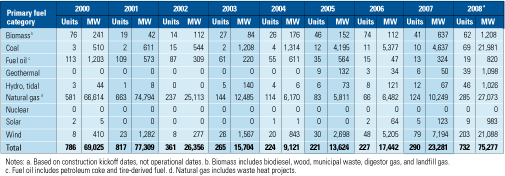

Table 3. U.S. power generation construction kickoff summary by primary fuel type (2000-2008). Source: Industrial Info Resources

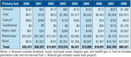

Table 4. Total installed cost of generation by construction kickoff year (in 2006 dollars) by fuel type, in millions of dollars. Source: Industrial Info Resources
