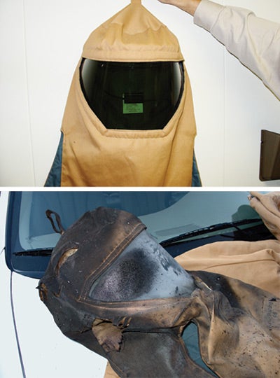

A 10-year study by Électricité de France found that arcing caused 77% of all recorded electrical injuries. Similarly, one corporation noted that up to 80% of its electrical injuries involve thermal burns due to arcing faults. The U.S. National Institute of Occupational Safety and Health (NIOSH) tabulated 44,363 electrical-related lost-workday cases from 1992 to 2001. Arc flash burns (Figures 1 and 2) accounted for 17,101 (or about 39%) of those cases.
1.  In your face. Flame-resistant shields and hoods protect the head, face, and eyes against the ultraviolet, infrared, radiant, and convective energies unleashed in an arc flash event. The damaged hood (bottom) protected a worker from serious injury during such an incident. The intense thermal energy produced by the flash caused the fabric to break open and char and the shield to bubble and blacken. Courtesy: Ferraz Shawmut High Power Test Laboratory

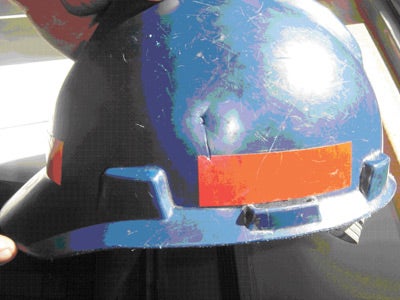

2. Hard head.
A hard hat worn by an electrician exposed to an arc flash prevented injury from shrapnel propelled by the event. Flame-resistant clothing protected him from thermal burns. Courtesy: DuPont
