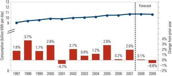

But NERC’s latest forecast provides reason for optimism that blackouts are not in the picture for 2009. "Lowered load forecasts for the coming ten years and new market mechanisms have contributed to generally improved capacity margins for most of North America," said NERC in its late October "2008 Long-Term Reliability Assessment." Slower economic performance is a reason (U.S. gross domestic product dropped 0.03% in the third quarter of 2008 and may also drop in the fourth quarter). As of Dec. 1, the country was officially in a recession, and that will likely mean reduced demand for energy, including electricity. The recession will also reduce the strain on existing electric infrastructure (Figure 1).
1. U.S. total electricity consumption dropping. The economic slowdown will impact consumption in all sectors, particularly the industrial sector, which is now expected to decline by 2.5% in 2009. Source: EIA Short-Term Energy Outlook, November 2008
