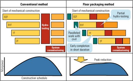

Here are two examples of benefits. To mitigate peaks in on-site labor force, Hitachi has adopted the "floor packaging" construction method (Figure 9). With floor packaging, hydro-testing is conducted at each "floor" (partial hydro-testing), rather than waiting for the entire plant to be completed. Equipment in the basement is hydro-tested while the higher floors are still under construction. Hitachi also has developed a weldless closure jig to make partial-pressure tests more efficient. This approach avoids the need to have a new group of workers on hand during the scheduled full hydro-test period.
9. From the ground up. Floor packaging of modules reduces installation and start-up labor and, more importantly, construction time. Source: Hitachi

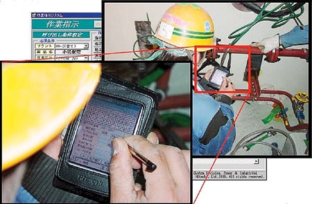

To better track equipment, Hitachi makes use of RFID tags instead of bar codes. The tags, which can be reprogrammed, contain silicon chips and antennae that send data to an RFID transceiver. The use of RFID eliminates the need to scan equipment bar codes, reduces counterfeiting, and makes parts identification more accurate by reducing the effect of dust and other ambient factors.

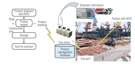

The switch to RFID improves the quality of piping assembly and component fabrication (Figure 10), ensures that workers are qualified to handle components, makes on-site storage more efficient, and streamlines database and document interfaces (Figure 11). Hitachi calls RFID a "ubiquitous technology" because it can be applied to advantage in all aspects of a project's design, engineering, procurement, transport, construction, and installation phases.
10. Gone digital. Radio frequency identification (RFID) and personal digital assistant (PDA) technologies are deployed across all parts of the project. Courtesy: Hitachi
11. Digital supply chain. RFID allows all movements of components, activities, and workers to be tracked and coordinated in engineering and document databases, which streamlines management. Courtesy: Hitachi
