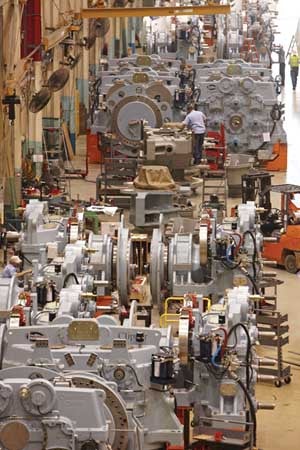

3. Gearboxes good to go. Upgraded gearboxes under assembly at the Clipper Windpower Cedar Rapids wind turbine manufacturing facility. Courtesy: Clipper Windpower
