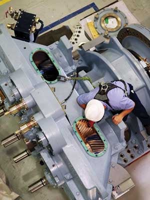

During root cause analysis (RCA), Clipper used the Six Sigma quality process. It spent three months determining the exact cause of the gear failure, identifying a corrective action, and validating it. As part of this effort, it brought two drivetrains back to its Cedar Rapids factory for teardown and component analysis.
"Improper timing in the drivetrain led to uneven stress between the gears," said Christenson. "In some cases, this had led to premature failure of the gear teeth."
The RCA revealed that gear sets from both of Clipper’s gearing suppliers had timing deficiencies due to supplier-related gear tolerance discrepancies. In response, suppliers improved their manufacturing processes, and Clipper developed a timing measurement fixture as well as a drivetrain test stand and qualification testing process in order to confirm proper timing in each unit by measuring load distribution in the gear mesh before approving the gearbox for shipment. Tooling and process improvements also were implemented at the gear vendors’ plants to verify gear set and timing quality before gears were shipped to Iowa (Figure 2).
2. Switching gears. Early gearboxes used by Clipper Windpower were victims of supplier-related gear tolerance discrepancies that caused gearbox failures. Clipper Windpower used root cause analysis techniques to develop action plans to resolve the problems, upgraded manufacturing techniques and quality control inspections, and replaced all the affected gearboxes in the field. Courtesy: Clipper Windpower
The RCA results were subjected to independent evaluation by engineers and consultants hired by First Wind. The owner’s representatives confirmed Clipper’s findings and supported the remediation plan, which included changing out the drivetrains at each of the eight Steel Winds turbines.
