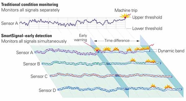

That integration is needed has been confirmed by data distilled from the Pearl Street surveys and interviews. Plant personnel are overwhelmed by data and alarms (see story p. 38). SmartSignal’s solution seeks to cut through the "data fog" to provide early detection of machine problems. In traditional condition-monitoring techniques, signals are monitored separately. SmartSignal’s software, in contrast, monitors all the signals simultaneously, correlates the data in real time, and provides alerts and warnings (Figure 3).
3. Early-warning system. Predictive analytics software monitors multiple signals and correlates them to provide early warning of problems and failures. Source: SmartSignal

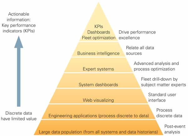

Many important power station applications from other software vendors, SmartSignal included, draw data continuously from OSIsoft’s PI system for individual plants and entire fleets. Many utilities today have taken a fleet-centric approach to managing their assets, facilitated by digital asset intelligence. Convey discussed how one leading utility, DTE Energy, uses OSIsoft PI to collect data and distribute actionable information through OSIsoft’s Process Book displays and a variety of third-party applications (Figure 4).
4. From data to actionable information. Performance excellence is driven through the organization via a hierarchy of knowledge management databases, software, and applications. (Diagram was simplified from original presentation version for clarity and general application.) Source: DTE Energy
