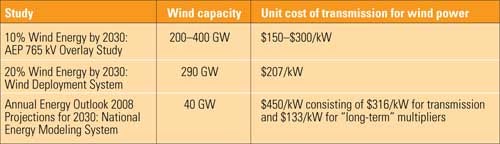

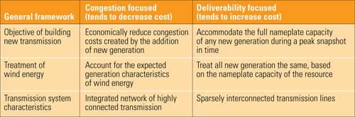

A recent Lawrence Berkeley National Laboratory study may provide an early answer to the cost question. It indicates that transmission unit costs for wind are only about $15/MWh (see sidebar).
However, that cost varies, depending on the configuration. For instance, the lowest cost scenario is having a concentrated pool of new power (thousands of megawatts). In this case a very high voltage line (765 kV) can transport that power very economically, even over great distances.
