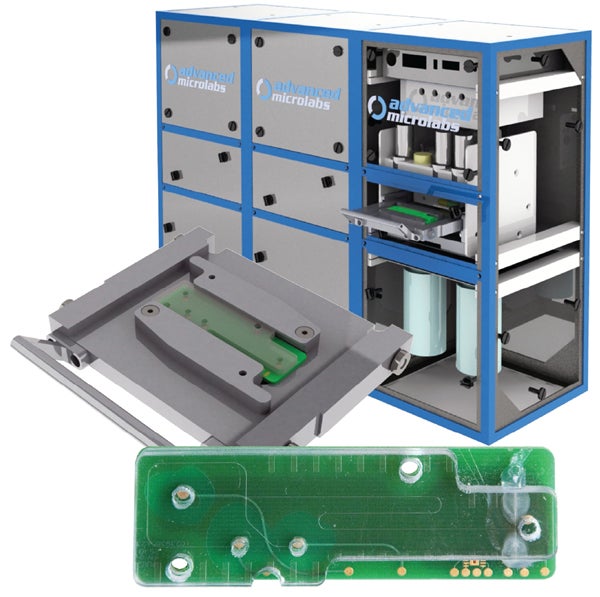

A similar process can be applied to inorganic ions. Capillary electrophoresis is currently under development by Advanced Microlabs of Fort Collins, Colo. A very small sample of known volume is injected into a capillary channel. The channel is flushed with a continuous supply of an electrolyte buffer. The ions separate as they pass through the channel and past a micro-conductivity meter at the end of the channel. This meter senses the change in conductivity as the ions are eluted out of the channel. The online instrument will take a continuous sample and filter a small portion of it through a 1-micron filter before sending it to the electrophoresis module. It takes a little more than 2 minutes for the sample to traverse the capillary electrophoresis channel and approximately 5 minutes between sample cycles. This equipment is designed to be continuously (every 5 minutes) sampling, analyzing, and producing data (Figure 2).
2. The capillary electrophoresis module. The thin S-shaped line in the middle of the “circuit board” is the ion channel through which the sample passes. The module can analyze levels of chloride and sulfate in parts per billion. Courtesy: Advanced Microlabs
The manufacturers of the equipment anticipate that a module will be in the analyzer for approximately one month and then be changed out with a new one. They are able to achieve detection limits of less than 1 ppb not only for chloride and sulfate, but soon should also be able to achieve these limits for silica, thereby pushing the limits of the classic spectrophotometric analyzer. Cations that can currently be determined include sodium, calcium, and magnesium; others, such as ammonium ion, are expected the near future.
To date, Advanced Microlabs has been working with nearby Colorado utilities to develop this process specifically for a utility market. Test units are currently in place, and Advanced Microlabs anticipates commercially available units in the second quarter of 2012.
