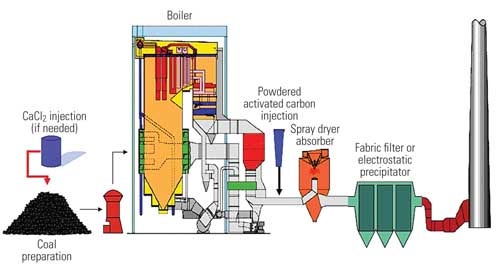

The emerging approach, Kumar told the audience, is a tricky mixture of chemical approaches, including powdered activated carbon injection into the gases coming off the combustor, along with injection of trona or calcium carbonate to reduce sulfur trioxide (SO3) in the exhaust gas. The big research discovery, Kumar said, is the role of SO3 in limiting the role of activated carbon injection. The SO3 gets on the activated carbon before the mercury, limiting the ability of the carbon sorbent injection to do its job (Figure 1).
1.    Injecting chemicals. Coal-fired power plant owners have many options for controlling mercury emissions. Source: Babcock & Wilcox

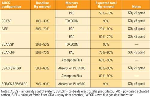

Getting the mercury job done, Kumar said, will require tailoring the chemical streams to the plant characteristics and its coal (see table). In the case of ESPs, he said, the additional particulate load from activated carbon injection can overwhelm the ESP, increasing particulate emissions and altering stack plume opacity. "This puts a premium on ESP maintenance," he said, noting that potentiality simply increases the need for best practices when it comes to ESP maintenance. That’s not a problem with bag houses, but they exist on few of today’s coal-fired plants. Adding them would mean major capital expenses, noted Kumar.
Different systems, different results. These are the mercury removal potentials for different AQCS technologies when a plant is firing bituminous coal. Source: Babcock & Wilcox
