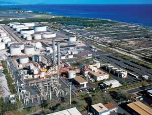

In addition, the plant supplies thermal energy in the form of steam to a local refinery, Tesoro Hawaii, one of only two refineries on the island. Kalaeloa provides 90% of the refinery’s thermal requirements and supplies approximately 20% to 25% of the entire island’s electrical generating capacity. The plant’s output is critical for meeting the energy needs of Oahu, the third-largest of the Hawaiian Islands (Figure 1).
1. Ocean-front property. The Kalaeloa Cogeneration Plant is in the foreground, with the Tesoro refinery’s wastewater treatment facility and fuel tanks behind it. Diamond Head and Honolulu are in the far background. Courtesy: Gary Hofheimer

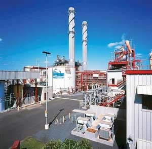

The plant comprises two ABB 85-MW (type 11NM) gas turbines, one ABB 51.5-MW extraction/ condensing steam turbine, two Deltak heat-recovery steam generators (HRSGs), and the balance-of-plant equipment that completes the combined cycle (Figure 2). The primary plant fuel is low-sulfur fuel oil. No. 2 diesel fuel is also used as short-time backup fuel and for start-up and shutdown of each gas turbine. Propane is used for the ignition of each gas turbine.
2. Powering Oahu. The Kalaeloa plant entrance with water demineralization plantand demineralization storage tank on the right; the steam turbine, control room, and administrative building on the left; and both stacks of the two combustion turbines in the background. Courtesy: Gary Hofheimer
