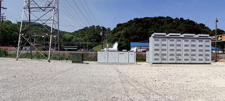

Welcome to the future of bulk electricity storage (see box). Earlier this year, American Electric Power (AEP) installed a 1.2-MW sodium sulfur (NaS) battery and accompanying inverter (Figure 1) at the Charleston Substation of its subsidiary, Appalachian Power. The Charleston Substation was chosen to host the installation for several reasons related to economics, service reliability, and local load growth.
1. Small package, big punch. The 1.2-MW Distributed Energy Storage System installed at the Charleston Substation of AEP's subsidiary, Appalachian Power. Courtesy: American Electric Power
The main function of the system is to supply up to 7.2 MWh of electrical energy on demand for peak-shaving purposes. However, it also has a business purpose. According to AEP, the system will enable deferment of equipment upgrades to the Charleston substation for six or seven years, at which time the battery can be relocated to another substation and play similar roles there. The battery's manufacturer—NGK Insulators Ltd. of Japan—expects the battery to last for 15 years, assuming that it will be charged and discharged 4,000 to 5,000 times up to 90% of its full capacity.
