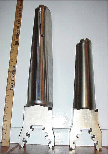

Because of TurboCare’s experience with many other longshank blade projects, the amount of drop—and therefore the amount of material removal required to ensure all the cracks were removed—was engineered and implemented with minimal delay. Concurrently, the design and manufacture of the replacement blades was started before the original blades were removed from the existing wheel.
The longshank redesign process also allowed the attachment form to be improved from stock conditions. The dovetail was machined with modified fillet radii to reduce the peak stresses for two reasons: to offset the additional weight from the longshank modification and to reduce the stress concentration factor of the geometry, which contributes to SCC (Figure 9). The reduction in peak stress is typically 10% to 15% for this modification.
9. Add longer blades. The blade on the left side is nearly identical to the L-2 longshank design used on this project. To accommodate the longer blade, the rotor must be machined to a reduced diameter and a new dovetail added. Courtesy: TurboCare Inc.

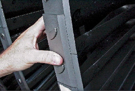

Another important feature of the design is the use of chain link or over/under shroud covers. This design replaces the original single shroud segment with a two-tiered shroud. The inner shroud is assembled with a clearance around the tenon, and the outer segment is rigidly connected to the upper section of the tenon (Figure 10). The inner and outer segments are circumferentially offset to provide a continuous coupling of the blade tips. This configuration provides a significant increase in vibration damping and also suppression of several fundamental vibration modes caused by steam path excitation. This design provides an additional vibration safety margin with the ability to supplement tuning of blade frequencies to avoid the impulse line (1X running speed) with both the five and six nodal diameters.
10. Lapped joints. A typical over/under shroud assembly was added to L-2 to continuously couple the blade tips. This design approach increases blade vibration damping. Courtesy: TurboCare Inc.
