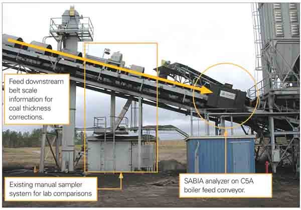

Once the unit was operating, additional dynamic comparative data samples were acquired using the existing sweep-arm mechanical sampler on the C5 belts (Figure 7). Given the number of seams and the large number of possible combinations of lignite supply, it took several weeks to collect sufficient data to complete a robust system calibration. During this initial performance optimization period, SABIA configured its systems to provide a data stream directly into the mine’s existing data management system with the purpose of providing the trend data stream directly to those mining the coal. More on that development later.
7. Looking at lignite. The coal feed moves from left to right down the conveyor. A belt scale collects information to make a coal thickness correction. Next, a manual sweep arm collects samples for lab comparisons. Finally, a SABIA PGNA sampler is installed on the conveyor that supplies fuel to the boiler. Courtesy: SABIA

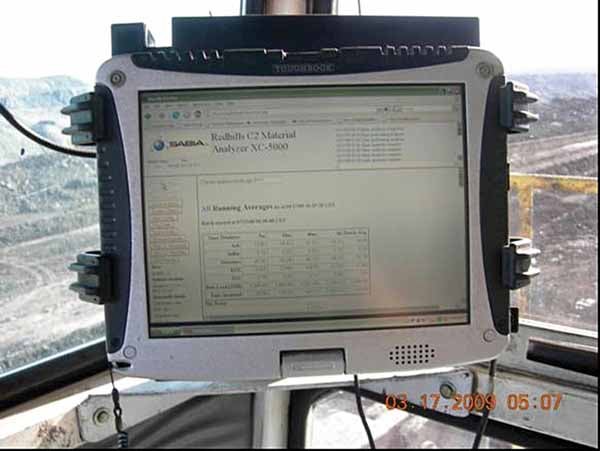

Red Hills Mine uses its wireless network in the open-pit mine so all the real-time information from the analyzer is available to the mining operation. A wireless router in the main mining office is linked to a Motorola mesh wireless network in the pit. Panasonic Tuffbook laptops with swivel displays were mounted in key vehicles used in the mine. Another laptop was mounted in the Easi-Miner (Figure 8), one in the Caterpillar 5230 backhoe, and one in the pickup of the shift supervisor. Together, the analyzer can display running average results displayed on a 5-minute, 10-minute, 40-minute, and 4-hour basis. The mine operators are typically making decisions on the 10- and 40-minute results.
8. Wealth of shared data. A Panasonic Tuffbook laptop was mounted in the Easi-Miner (shown), in the Caterpillar 5230 backhoe, and in the pickup of the shift supervisor. The analyzer can display running average results on a 5-minute, 10-minute, 40-minute, and 4-hour basis. The operators typically are making decisions on the 10- and 40-minute results. Courtesy: SABIA
