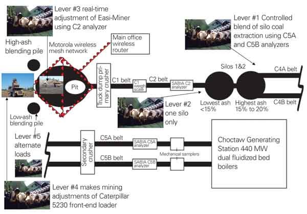

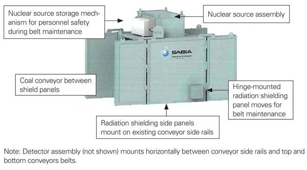

Once the technology was selected, the best supplier was chosen. Red Hills Mine had several key specifications for the supplier beyond first cost and experience with coal. For example, the interface with the PGNA should be through a web browser to minimize operator training. After closely comparing three different vendor offerings, Red Hills Mine selected SABIA’s PGNA analyzer (Figure 5). SABIA’s willingness to do a demonstration project and put a unit on-site for a six-month trial lease was one of the deciding factors for its selection. In addition, SABIA’s experimental moisture meter also promised improved measurement results in the future. The six-month trial run with a PGNA analyzer on conveyor 5A was a success, and Red Hills Mine subsequently leased three PGNA analyzers for five years: one each for conveyors C5A and C5B and a third on the C2 belt just downstream of the truck dump/primary crusher (Figure 6).
5. PGNA plays a key role. Three SABIA PGNA instrumentation packages were installed at the Red Hills Power Plant to provide real-time lignite fuel quality measurements. Source: SABIA
6. Sharing real-time data. Data collected by the PGNA systems are fed back directly to the Red Hills Mine operators’ computers through their intranet, so all the information from the analyzers is available in real time, enabling operators to quickly change fuel collection locations when fuel quality drops. Source: SABIA
