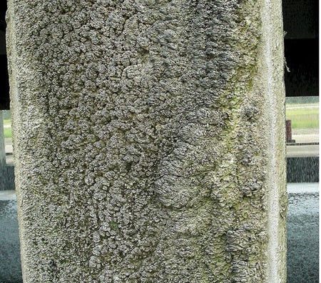

Minimizing the accumulation of airborne particulate matter may be as simple as better housekeeping in the area of the towers. Better control of ash piles or dust suppression on roads and the coal pile may also produce significant benefits (Figure 3).
3. Airborne contaminants. The close proximity of the ash-loading area has caused particulate accumulation on this tower support. Courtesy: M&M Engineering Associates Inc.
